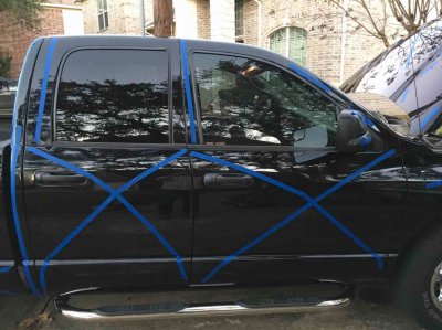

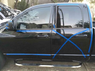

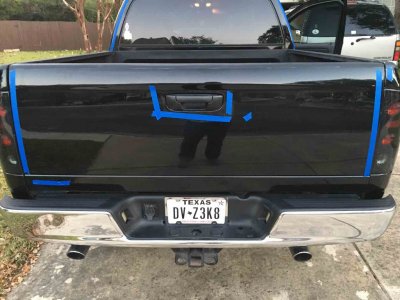

Finally getting my truck painted
All I can say is ugh!!!!!! [emoji35]
I dropped the truck off Tuesday and marked all the flaws with painters tape so the shop knew exactly what needed to be fixed.
I even emailed him a description of all the issues to be fixed along with the inspection/gig sheet the office manager and I did when I got the truck back after wet sanding and buffing on 1 November. All the problems were called out then other than pointing out the roof issues as I ran out of energy writing gigs.

Essentially every panel had something wrong to include the roof, which was the original motivation to get the truck painted. The entire roof had paint failure.
When I showed up today neither the owner nor office manager were there.
I get the truck and only the passenger side is done. They even left the tape residue on the other panels and left the blue tape intact on the roof!!!!
They had just reshot the center of the bed with bed liner as what they did in the past was already failing in spots. They didn't even bother to reshoot the sides that had chips and failure while they were at it.
I called the owner and he immediately got defensive saying the roof wasn't his problem to fix and the other areas just had "minor imperfections" that didn't need fixing.
