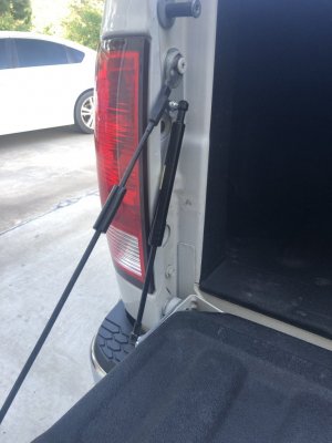

Installed the Dee Zee tailgate assist and liking it so far. Honestly the tailgate is very light compared to the 3rd gen so it would have been more useful on that truck lol. Good mod for 20ish dollars.

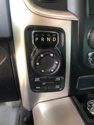

Installed my new AJT shift knob. This thing is BEEFY. Definitely feels more like a shifter than a radio dial. I didn’t like the look of B&M or others.
Rav3ncroft
Jun 14, 2020
794
813
Indiana
2018 RCSB Sport
Looking good. I think it's one of the best upgrades I've done.

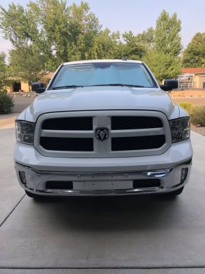

Did my first mod tonight. Found a BAKFlip cover on FB market place for a steal, 250 cash. It’s a bit older but it’ll work for my needs. Have a tailgate assist and a stubby antenna coming in soon as well. a13eb4426643dd8d83af9c1695cda0f5.jpg

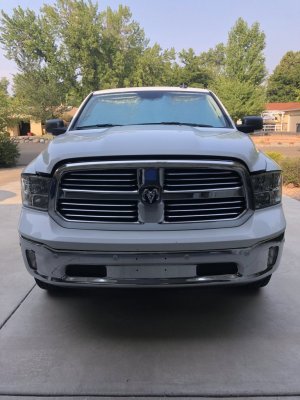

Facebook Marketplace continues to give treasures. Found an OEM sport grille for cheap, decided why not as I'm slowly doing away with the chrome on the truck. It has a few nicks here and there but otherwise great condition, not mounting tabs or anything broken. IMG_4368.JPG IMG_4369.JPG

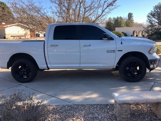

First mod of the new year. Found someone selling stock powder coated black rims from a sport or other model. Picked them up for Dailey cheap and got them mounted. They have a few nicks on them but nothing crazy. It’s the looks I’ve been searching for.
