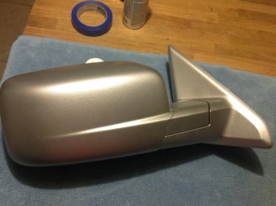

Well, here are my results. Sanded, adhesion promoter, about 5 thin coats, resanded, cleared, wet sanded, polished and waxed. Not super pleased. They don't look terrible but they are not very shiny. Just not sure you can get much shine out of a can. Idk if I'll leave them on or not.

Now I'm wondering if I could just pop these off, take them to a local shop and they could clear them for me. Surely that wouldn't be too much and then I'd have the shine I'm after.

If you only cleared them ONCE. That's why they are not shiny. Do 3-4 coats of clear.

Looks really good. I did 3 coats of clear. Followed the directions, waited 10 minutes between coats.

So what's the consensus on where I've screwed up? I sanded it, adhesion promoter, painted it with dupli color paint, cleared it with dupli color clear, wet sanded, polished and waxed and I still don't have much shine. It's smooth to the touch, just not as shiny and the other paint.
