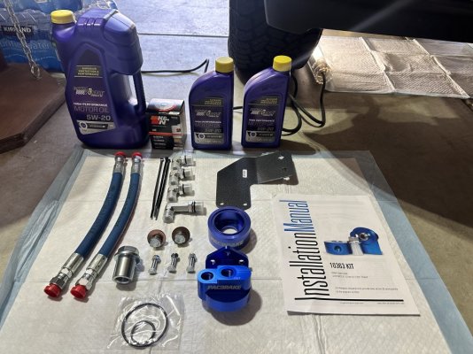

Got tired of the stock filter location and the mess associated with. Installed the Packbrake Oil Filter Relocation Kit along with a Fumoto Oil Drain Valve and oil changes are a lot quicker, cleaner, and easier on my post carpal tunnel surgery hands.

Love my fumoto. Got the oil udder for the filter. Have not used it yet but looking forward to it.
I went the ValvoMax route with fewer external parts and a lower profile.
