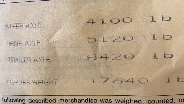

I’ve been towing my 5W for quite a while now but did my first CAT weigh in today. I thought I’d throw it out there for folks to estimate what you might be hauling but haven’t gone to a CAT scale yet.
- 2021 CC Tradesman 4x4, hemi, 4.10’s.
Base weight 6700, 3850 front, 2850 rear.
Payload 3060, GVW 10,000, GCVW
23,000, tow rating 16,800, max rear axle
weight 6300
- Arctic Wolf 34’ 5W, 8450 dry, 11,400 max
load, 1250 pin weight
I didn’t unhook the 5W but backing off the weight of my slider, adapter and some cargo I figure I had a total about 1900 lbs of trailer sitting in there, for a total of 10,300. We’re full timers so carry quite a bit. Anyway, hope this helps some who haven’t weighed yet.16D2B128-888F-41E3-AF86-50C206DE41DD.jpeg

Very similar to the weights I got this spring towing a 2021 Grand Design Imagine 3250BH. Truck empty (3 of us in it) was 8000lbs. with 4400 front and 3600 rear. The trailer weighed 9300lbs and was empty off the dealer lot except they 53 gallons they left in the fresh water tank. With the trailer connected we were at 4140 front axle, rear axle (9300lbs total so 1300lbs tongue weight) with trailer axle at 8160lbs. Total weight was 17,260lbs.
My truck is a 2018 2500 6.4 CCSB 4.10's with 2973lbs payload

Your printed ticket sure was prettier than the one I got ! :)
