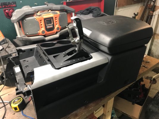

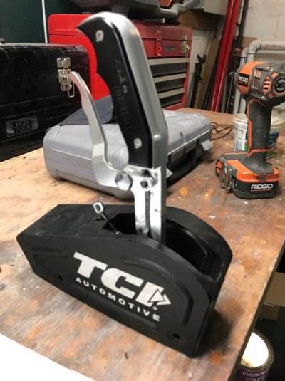

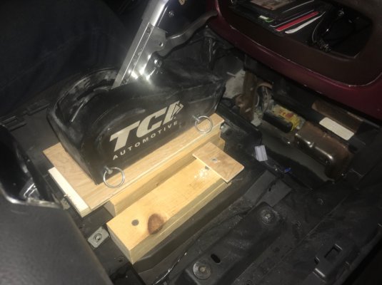

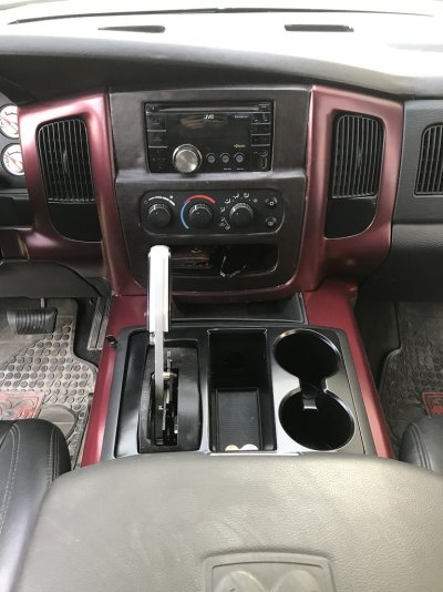

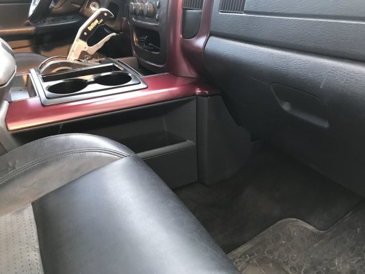

Yes I will be using a shifter. I haven’t updated this in a little while but I have been getting some stuff done slowly. And 2, I did not have any plans to use a 4th gen column, I don’t even know it that’s possible or not. It might look sweet, it might be worth thinking about.
Now for a progress report.

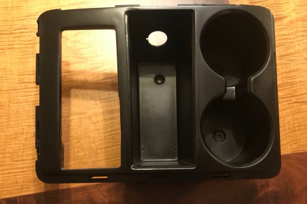

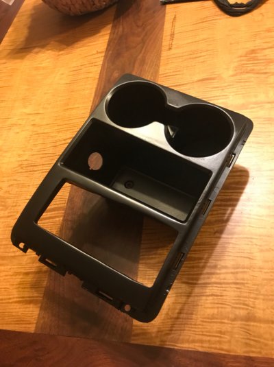

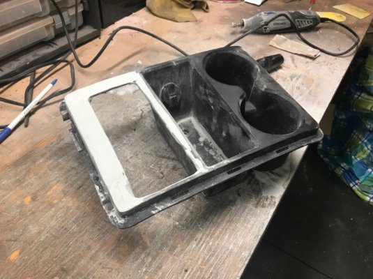

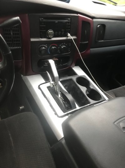

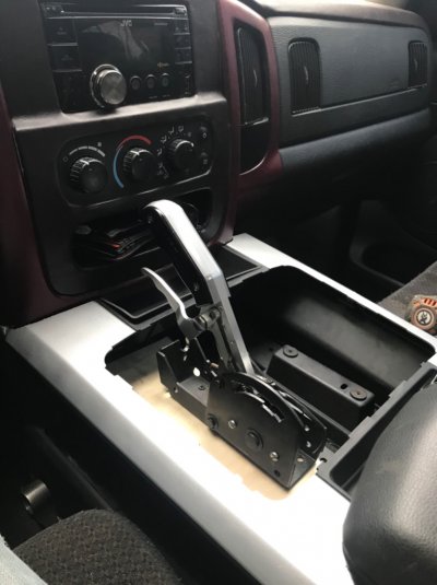

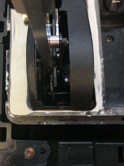

I picked up a TCI Outlaw shifter from Redtruck_Va, and I’m very happy with how it looks and works. It was pretty easy to mount up, I didn’t make anything crazy up, just screwed down a few boards to the console to get the height I wanted. The console has a nice flat spot to mount the shifter to, and it’s pretty solid. It took a lot of time trimming and fitting the hole through the cup holder trim piece, and then using body filler to smooth out the holes that were left. I’m almost done painting it

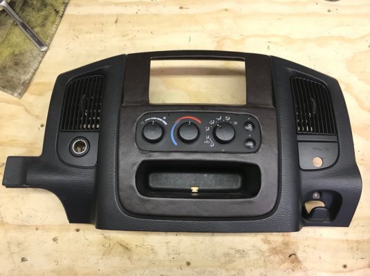

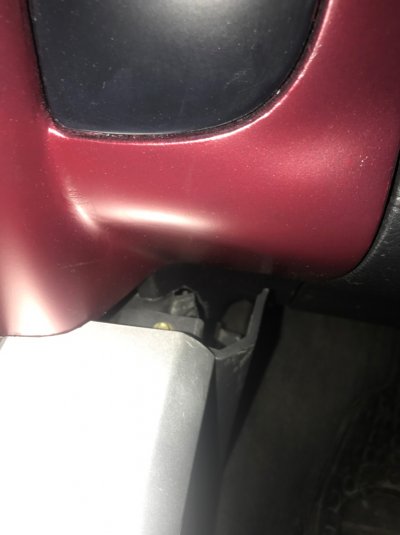

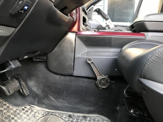

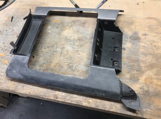

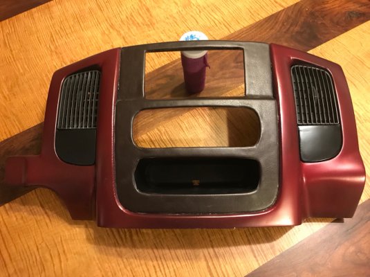

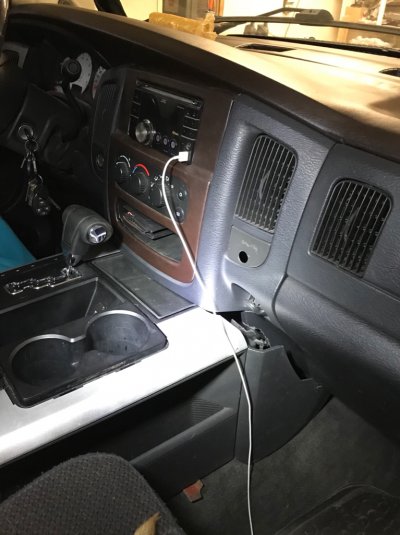

And now I’m working on fixing the gap on the passenger side down by where the bag hook used to be. I had to plastic weld some pieces to make a support to add body filler, then I’ll have to contour and sand it to fit perfectly. I smoothed the radio bezel and filled in the bag holder clip, that will make it easier for the console to fit nicely

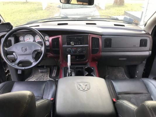

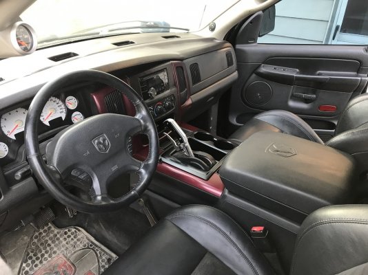

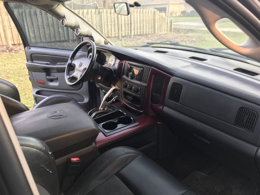

All done. Here is a link to all the pictures
