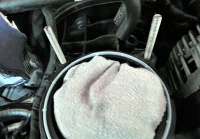

Well about 3 bucks in parts and an hour ,he's back on the road.Ended up drilling and tapping the holes for some 1/4" studs.Everything tightens up,and probably tightens up better then the original screws did.But i told him to buy himself a 8mm and a 7/16" nutdriver,and from now on don't go gorrilla on the bolts.He was using a 3/8" drive rachet to tighten things up,i told him to throw that damn rachet away when he's working on plastic,and go buy himself a decent little 1/4" drive rachet and socket set and use the nutdriver in it from now on when he's tightening bolts/screws into plastic.The factory should probably have done it this way,but they probably weren't thinking about the guys who want to make the trucks quicker and are occassionally removing the throttle body. My hacksaw blade was getting a little dull by the time i was cutting the screwdriver slots,so if the screwdriver slots look a bit wonky,they are,but they do the job,and i wasn't making another set of studs,lol
