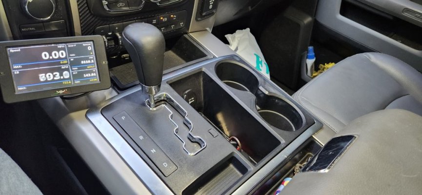

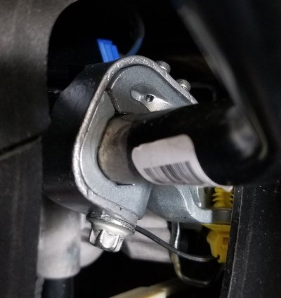

Shifting into reverse to come out of a parking spot, I heard a "pop" and the column shifter flops around like a fish. Luckily, I was able to shift into drive and get home. In the driveway, I pull the boot to have a look at the innards and sure enough, the shifter bracket is broken. Looking at this bracket, I'm thinking what brilliant engineer designed this? A cheap cast aluminum part that's supposed to clamp around a hollow shifter rod and subject to being yanked on 50+ times per day. That'll hold up, right?

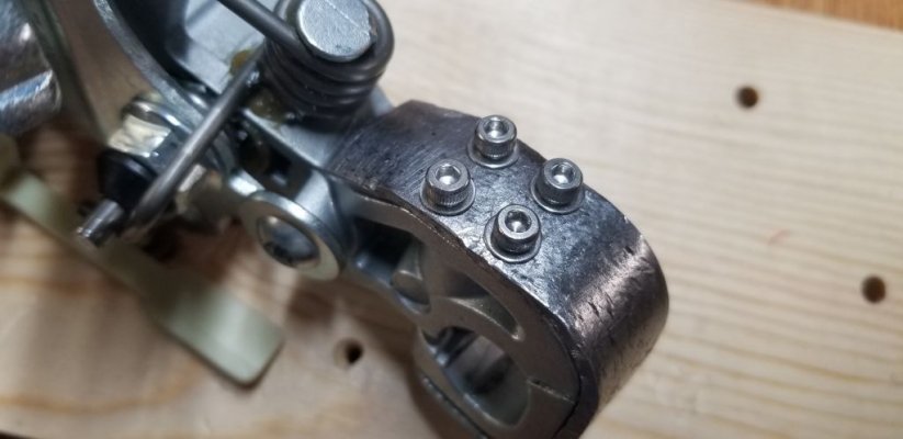

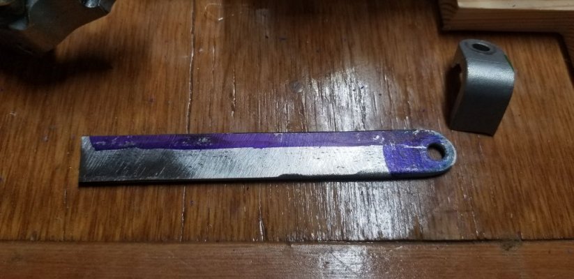

My first thought was to just buy a new bracket. They're less than $100, but it was Sunday and I was about to head out on a trip. Besides, what makes me think that the newer brackets are any better than the one that broke? So, here's my fix. I started off with some scrap steel, probably 3/16" thick or so. I drilled a hole at one end for the clamping bolt, then gently massaged it (read merciless beating with a ball peen hammer) to wrap around the broken piece.
I then drilled and tapped 4 holes near the free end of the strap into what looked like the meatiest part of the bracket. Basically, the broken piece is now a spacer for the shifter and the steel strap is the actual clamp.
A shot of silver paint and reinstall and now the shifter feels better than ever. Hopefully I'll never have to worry about this part ever again
