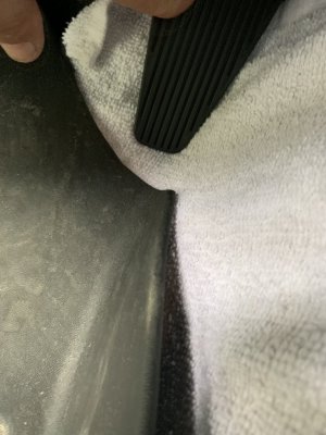

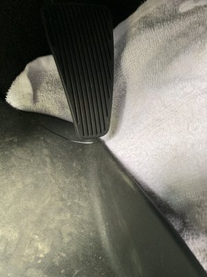

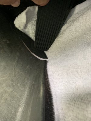

I have a 2019 ram 1500 classic I ordered the oEDreo floor mats and last night on the highway when I’m matted the gas the gas pedal got hung under the floor mat and kept the truck at wide open throttle
Which cause the truck to exceed 100 miles an hour. The problem is in the perfect conditions the upper right corner of the drivers floor mat can catch on the throttle pedal.
The fix is simple to just relieve the upper right corner by cutting away a quarter to half inch of the floor mat
I have attached photos
My assumption is that manufactures of similar floor mats i.e. heavy duty snow and mud floor mats may have a similar issue
If you check your truck it may look As if it’s not an issue but that the pedal gets very close to the top edge of the mat but in the perfect condition with Forward pressure the bottom left corner of the throttle pedal can get stuck under the lip edge of the mat. I would strongly suggest if when you check your truck and you press the gas pedal all the way to the floor if the Matt is within a quarter inch or less from the throttle that you cut away additional material so you have at least a half inch gap

No Problem, I do not need replacements as I have already made a relief cut as you can see from my photos above. However, I would ask that you do research my order and or utilize my photos above and determine if these were the new design or old design. If these are actually the new design then they need more of a relief made around the gas pedal. Again, we are not talking a major change to the overall mat, just another 1/4 inch or so.
Again, you have a good product here. And this was most likely a 1 in a 1000 possibility, but a safety risk even of that small amount is still a safety risk. I personally know I can feel better knowing that I brought this to your attention as well as fellow owners of 4th Gen Rams. My hope would be that as a company the design would be modified (if not already), and that fellow Ram owners would be aware, and could take a look and make the decision for themselves as to what they need to do.
