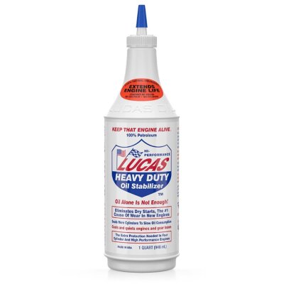

Also remember if it only has 59 miles on it, you're still running it's original break-in oil so if it's bothering you go ahead and just change the oil itself using the correct oil and after break-in mileage has been met, I'd suggest using Lucas Oil Stabilizer at the suggested 10% ratio it says on the bottle.
The filter should be OK with no need to change it and I'd run it like it should be ran for break in from here.
As for Lucas, it's good stuff and will help the engine to last so if possible I'd use it with every oil change and be done with it. Just follow the directions on the bottle and it will work.
I've posted a pic of the exact stuff to get - It is more expensive per oil change to use it but worth it and as an example, my old 91 S10 with a 4.3Ltr currently has over 300,000 miles and still running strong after 28 years of using it, so I can testify to it's worth in that sense.

Well, IMHO I wouldn't use Lucas Heavy Duty oil stabilizer ...
I would suggest reading/asking questions about the use of Lucas Oil additives in the engine oil for the troublesome HEMI engine over in the synthetic oil thread, as I'm not the expert for advise, but know it's not a good idea from reading RAMforum members expertise on the subject.

Good point about asking, nothing wrong with doing that.
I'm not aware of it causing problems myself and it does say on the bottle it won't void engine warranties BUT at the same time your point is a good one.
I'll dig into that for myself and see what's said and suggest the OP do the same.
I just know from personal experience, over time it's never caused a problem since I only use it at it's suggested 10% useage and that's in every engine I've ever ran it in, including imports and so on - Even in my old motorcycle (2003 Honda Shadow ACE 750) which I still have and yes, it runs but does need some work of course.
I also did a quick calculation and for 7 qts, it's about 22oz you'd use out of 224 oz/7qts (10%) so it's not like it's really thickening up the oil anyway because it doesn't. Some might use too much and that's when it WILL cause problems, thinking they can use "This or that" much (Guessing) when you really can't.

... not that Lucas Oil Additives causes problems, but rather it isn't an popular approach for an oil lubrication strategy for the troublesome HEMI, lol.

You still made a good point and it's worth digging into.
After 40+ years of doing this kind of work I've seen alot, just not all and I'll never say that with seriousness. Not too long ago when working on a 1930 Model A for a friend, I discovered a few things that sounds crazy but it's true - One being the "Oogah" horn it had needing to be lubed at times.
There is no one solution that fits all, that's why it's good and I do suggest some research "Just in case". ;)
