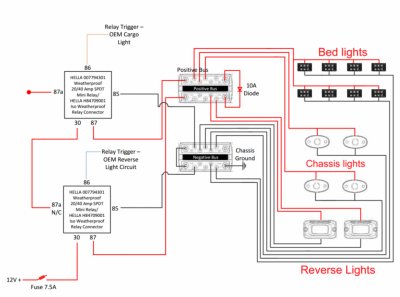

    Yeah I am adding a second set to mine. The ones I have now turn on when I got into reverse. I want the second set on a switch.

    I used a jig saw and all 4 are on a switch

    I have the same lights, their harness & rocker switches are pretty decent quality as well.
    I used a fizz wheel and finished up with a body saw. I had the bumper and bezels painted body color, and put some dum-dum/butyl tape behind it before I bolted them together.
    I only have 2 lights & that’s bright, 4 has to be like looking at the sun.
