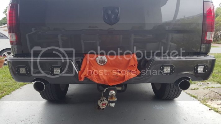

This is how I did it
**** quoted the wrong thing
Drill a hole in each corner and cut with jig saw

I have the same lights, their harness & rocker switches are pretty decent quality as well.
I used a fizz wheel and finished up with a body saw. I had the bumper and bezels painted body color, and put some dum-dum/butyl tape behind it before I bolted them together.
I only have 2 lights & that’s bright, 4 has to be like looking at the sun.

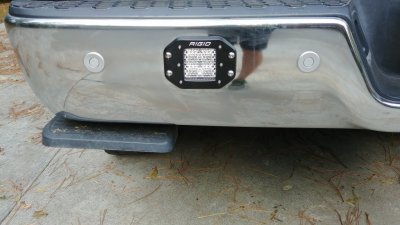

My Rigid's have a small rubber gasket that helped take a up the little bit of curve in the bumper.
