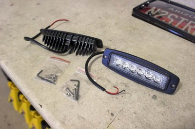

I've been doing this since 2005. One of my favorite mods and love the extra light. Normally I've done the square LED Pod lights, but this time saw these and wanted to give them a try. The more I see them, the more they grow on me, kind of like the cube style more but too late now since I cut the bumper :)
Made a harness and wrapped it in loom. Looks 100% factory under the truck, another thing I like.
I'll get some night shots tonight.

Very cool. What do you use to cut the bumper? Been thinking about putting a 2 row in the front. But want to do a super nice cut to accommodate the light. And thinking of the rear

Drilled a hole in each corner, disconnected the sensor harness, and used a metal blade on a my jig saw. Cut it like butter. Lots of control.
