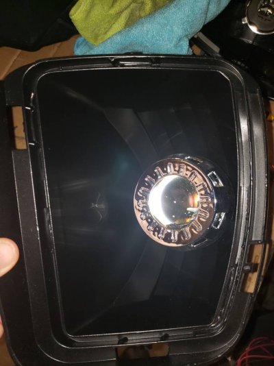

What they look like with satin black.4740e0b033f24194d6a149985802c05e.jpgef3f63303d5cf18fe81a34eaaafa2eda.jpg

I like how the Micro Gatlings secure to the projector with small screws. Not like the other shrouds.
