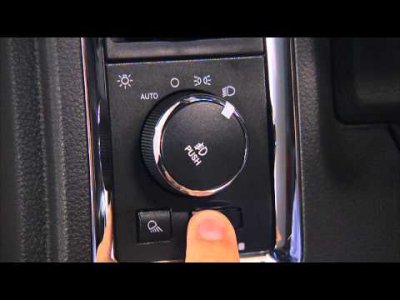

Thus is the button I'm referring to. If it's not fog then what is it if I can know?

Turns on the bed lights that is incorporated with your roof third brake light assembly.

^^ What these guys said. If you had fog lights, to turn them on you would push the headlight button in

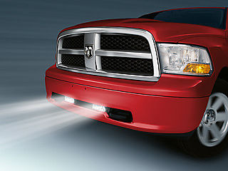

You could still swap in a bumper that has the fog light holes. You would need the bumper, the light bracket and your own wiring harness/relay/switch.

Ok then thank you all for the imput I thought it was for fog lights lol. I do like the fog light look so I will be getting one and wiring it up once again thanks

The OEM fog light kit posted by lukedukem has several advantages.
All the parts you will need are there.
The factory fog light indicator in instrument cluster will work with this.
The factory fuse box under the hood is already equipped for the fogs.
You won't need to drill any holes!

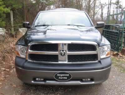

I custom mounted mine in place of the tow hooks. It required a little fabrication of the mounts. If you stay with the original location of the kit, the brackets just bolt on.
