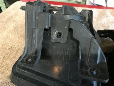

68104821AF & 68104820AF
These are the part numbers I ordered and got the redesigned fog lights. When I go home for lunch I'll take a picture of what they look like after the update.

Old style fog light....
New style fog light....

Thanks for the part numbers and pictures.
