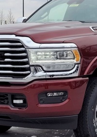

Not for cornering lights. It’s the fogs only. Do you have these headlights pictured below? If so, they are adaptive, and the projectors actually “look” in the direction of steering wheel input. Completely different feature than the cornering lights. g2UU5G3.jpg

Yes, I have those headlights....I know they turn with steering and all, what I was referring to was I have noticed whether I have high beams or low beams on, (fog light switch in the on position) that the cornering light always comes on. The fogs don't get any brighter, unless there is another light facing outboard in the fogs. I was thinking the way the cornering light comes on, it might be in a different part of the headlight. I'm going to have someone video it to check, because I can't tell where it is coming from when I'm driving it.
