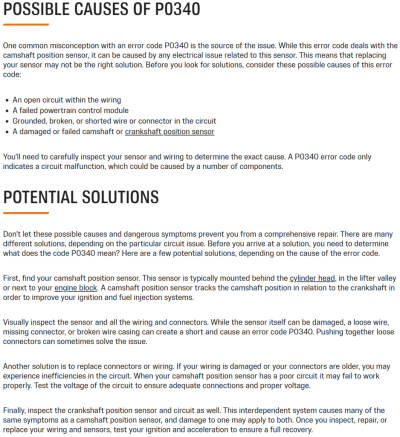

Important to note P0340 is for Camshaft Position Sensor - not Crankshaft. Hopefully something like this can assist you in trouble shooting.
