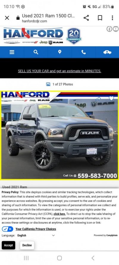

I just bought a 2021 Ram 1500 Classic Warlock. It didn't come with fog lights. I have been looking for a kit with the lights and the cover piece but can't find the right ones for the Warlock. Anyone know the right ones to get. Would like smoke if possible. Screenshot_20230111_101022_Chrome.jpg

Your truck will be a 4th gen parts list. There are a few good write ups on this already. Just need to search.

Being that you essentially have the Rebel bumper, that’s where I’d start.

As others did, I bought a OEM switch and OEM harness from allmoparparts in Vendors, a wiring harness from M²Mods to connect the OEM harness to the fuse block. AlphaOBD was used to enable the OEM switch to function. In my case I had to use aftermarket lights and mounts as my truck did not have fog lamp knockouts as your truck appears to have. Also work with allmoparparts for the factory lights. Read through the 4th gen section on adding for tips. Good luck.
