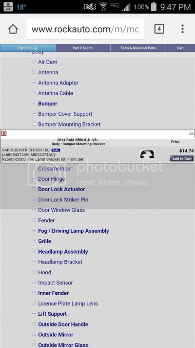

Do you have the part # for the the bracket pair?
