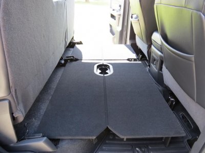

There was someone in the Gen 4 group who had pictures and maybe plans for building one out of plywood and piano hinges. Probably in the DIY section---all I can recall is seeing the pictures. It had 2 large sections making up the floor and 1 short section that folded down to support the front edge.

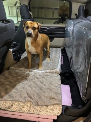

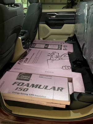

I liked the fold flat floor for hauling my dog around. Futher to my post above back in December, see the pictures below:
Pic 1 - I purchased carpet protector from Home Depot and placed it on the bottom of the seats as dog hair gets matted into the carpet fibers after time. It is similar to Cling Wrap but stickier on one side and is made to be adhered and removed from carpet. This layer has been on since November 2019 when I just slapped it on as an experiment and you can see it is starting to peel off so will replace before summer. Home Depot sells in in a roll and there are almost twelve sets of applications you can do with one roll so will last quite a while. And no, when the "dog floor" is removed and the seats are down, you don't see the carpet protector at all.
Pic 2 - I took the insulation board and cut it to fit the floor. It isn't pretty but it works. One sheet gives you enough for two thicknesses high which I glued together into one sheet. I can lift it out and placed in the bed of my truck so it is out of the way when passengers ride in the back seat (I have a topper so the insulation and dog beds are out of the elements when in the bed of the truck).
Pic 3 - Then I lay the first full size dog bed on top of one end of the "insulation floor" (the dog beds are from Sams Club).
Pic 4 - I then lay down the other end of the dog bed in which I took another full size bed but cut the foam down as the cab isn't quite two dog beds wide but roughly 1.5 to 1.7 wide. I just cut the foam to fit and reinserted it into the dog bed. These have zippers on them so easy to cut the foam and also super easy to remove the foam from time to time and throw the bed covers in the washer/dryer...keeps the truck smelling clean 100% of the time.
Pic 5 - The dog loves it and can see out the window for that "tongue in the wind" action. (No more muttering of "This is ********! Should have kept the 2018 with the fold flat floor" as he jumps into the truck.)

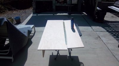

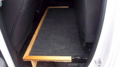

I built a simple one, quick and dirty. 1 sheet of 1/2" plywood and 2 piano hinges. Added some old scrap carpet and 1X2 edge guards. It folds up and slides out easily if needed.100_2178.JPG 100_2179.JPG
