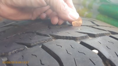

I had horrible luck with the Fox rear shocks. 40xxx miles max and they started squeeking. I got 120xxx out of my first set of fronts. I have 30xxx on the second set of 2.0's. Zone upper control arms. Ball joint was still perfect at 120xxx, but changed it anyways because front end was apart. I got 106xxx miles out of the Cooper AT3 275/65/20 10ply tires. Can't say enough about the FOX coilovers and Zone control arms. Tires started getting louder about 90xxx but tread said to keep running them. Pictures are of two different tires, but all 4 are in the same wear depth.2018-03-08-09-13-37.jpg 2018-03-08-09-13-50.jpg
