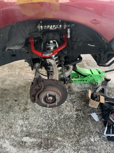

I know it’s not your cup of tea price wise. I love my fox 2.5 from accutune thought. Haven’t had a chance to take it on high speed off-roading but they handle extremely well on road and through trails. I’ll be going back out on some easier trails in a month or so. Truck has eibach rear lift springs as well. Sits around 2.5” front lift with 1” rear lift.
