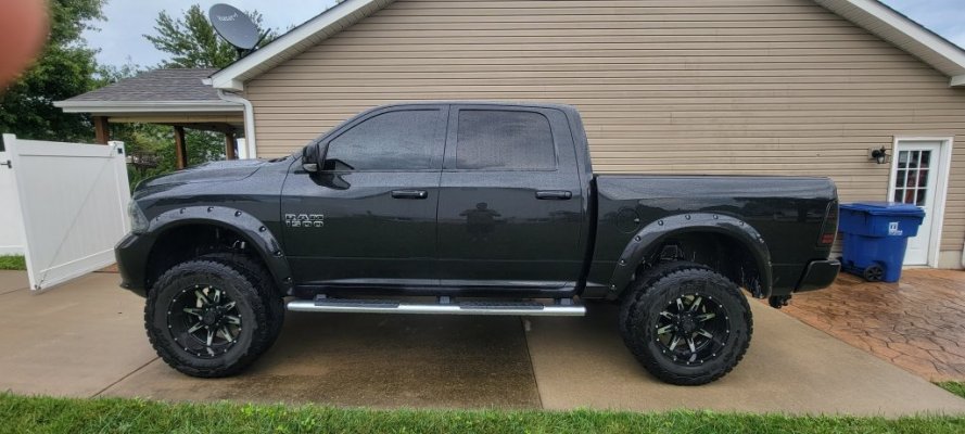

I have the 5" rear bds coils and the fox 2.5 I got lifted the front 2 inches. There was quite a rake before but it looks level now. I am very happy with the results. Makes the truck look a bit more tough and I still have about a quarter inch to eighth inch of clearance to 7 ft.

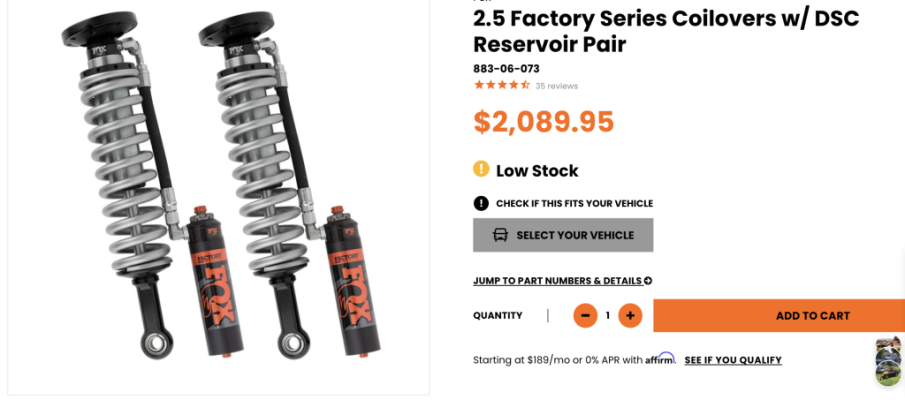

hi, sorry I was doing a search and with that part number (883-06-073) they had to provide you with the fox 2.5 with dsc but the factory model, instead they sent you the ones with the orange tank which are the superior version for offroad racing. Did you request an upgrade or did I miss something in the posts?
I did not request anything special, that's just what they sent me. I ordered from shock surplus af the time as they were $300 cheaper and offer %25 off rebuild costs if bought through them. Looking at their site now, they do show the orange and black ones whereas they showed the silver and blue ones prior.

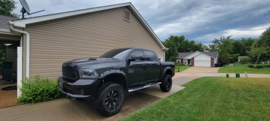

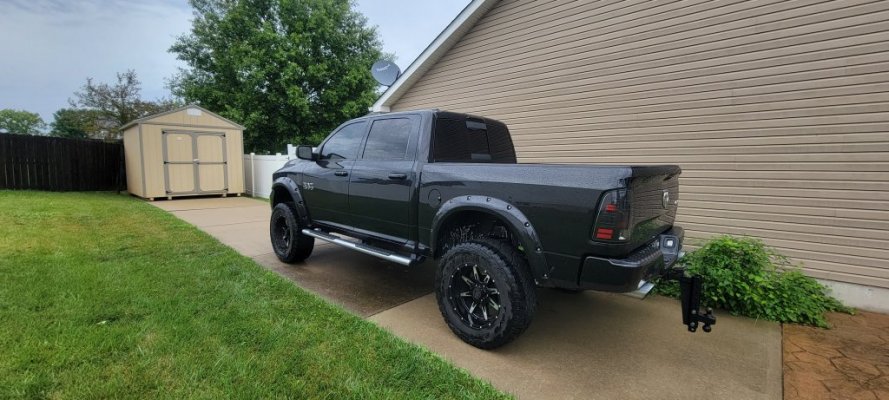

Here's some pics. Sorry it took so long, been busy and had rain. Note that the truck is not sitting on level ground. The rear does sit a smidgen lower on the driveway. I tried to take the pictures level but was a little off. At least included the edge of the driveway so you could tilt the picture a tad bit as if the driveway were level. Looks pretty level on level ground.
Here's my notes on before and after measurements if you're interested. I took height measurements using a long level on the roof with a digital distance laser measurer. Wheel well distances by using tape measurer. I also did measure the rear as I replaced the old fox 2.0s in back with the same thing.
Low profile Antenna adds .25"
Current strut is 19.5" and has 5" spacer
Height now 6'10.625"
Height from the top of the fin lifted 2 inches 6'11 19/32"
AFTER height from top of the fin 6'11.75"
Stock height from the top the fin 6'11 3/16"
All measurements to mid bottom of flare or oem wheel well.
Back passenger
Floor to flare 46"
Tire top to flare 10.75"
After floor to flare 46"
Front passenger
Floor to flare 42 15/16"
Tire top to flare 8"bin
After floor to flare 45.5"
After Tire top to flare 10 5/8 "
Back driver
Floor to flare 45.625"
Floor to oem fender 46"
Tire top to flare 10.375"
Tire top to owm flare 10.625"
After Tire top to flare 10.375"
Front Driver
Floor to flare 43.25"
Tire top to flare 8.125"
After Tire top to flare 10.5"
Shock 30.0625" eye to eye
31.75 overall

These are the fox's BDS had built for the 6 inch lift kit and are 4 inches taller and provide 0 to 2 inches of adjustment. I know the numbers seem wonkity, but it works and I didn't adjust the height on the coilovers at all. I also got some bad information and bought a half inch spacer anticipating needed to put it on top of the shocks, which was not needed and would have resulted me in being nose high. I also almost returned these shocks and went with the ones that would have required me to put the BDS spacer ontop of. I'm so glad I didn't. The numbers weren't making sense to me and it was driving me crazy. Luckily I PMed @Quick_Shifter for his expertise and he assured me what I had was the right setup for my goals and to just install and adjust later if necessary. It was spot on.

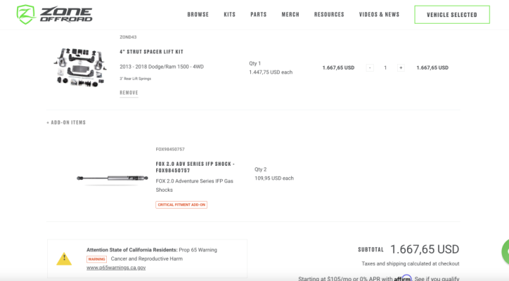

Hi guys, I'm revisiting the post because I decided to upgrade after various experiments with the Bilsteins which didn't leave me satisfied and I also want to lift a bit more my ram and make it very cool !
I decided to purchase the 4" zone kit with the following features:
For the rear:
3" springs + FOX 2.0 Adv Series IFP Shock - FOX98450757 (X2)
At the front I will not use the 5" strut supplied but I will install this coilovers fox :
FACTORY RACE SERIES 2.5 COIL-OVER RESERVOIR SHOCK (PAIR) - ADJUSTABLE. 4-6" 883-06-073
The foxes without any adjustment already give 4" of height, I want to adjust them to have an additional 1" and reach 5" (do you know how many turns with the key you need to give to the upper collar with the holes to have 1" of the maximum 2" of extension available ? )
I want to understand if you recommend me to buy the Zone upper arms or I can use the stock ones or is it better to change them with some other brand that has better characteristics, also for the lower arms which could be slightly worn (I accept advice)
I want to try this configuration with 3" at the rear and 4.5 or 5" at the front and race with my 33" wheels which are still in excellent condition...later on if the wheels seem too small switch to 35/12.5r20.
The shop that will have to carry out the work will purchase in the United States so any message with a personalized quote and further advice on some parts that I might need to improve the ram is welcome.
