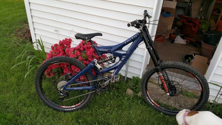

Nice ride! On one of my other bikes I ran 888’s up front too!

No wonder you want your truck to ride plush
