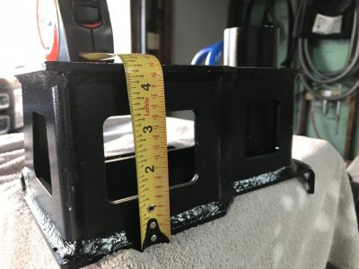

The rear spacer is a combination spring mount and bump stop bracket. It’s a nice heavy duty bracket. The procomp lift raises the rear 4.5” so you’ll be a 1-1/2” shorter with the 3” coils.
I just took a pic of the procomp bracket, I have a set in my garage.
