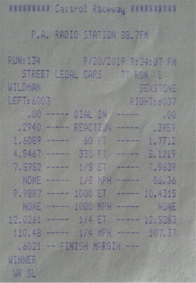

Well my truck runs 12 flats at Castrol and gives stick Hellcats fits,so that'll give you an idea of it's power level,lol.Last time on the dyno it put down 500 rwhp and 572 lb-ft at 3200,so it's pulling some air,right off idle. But the rag test was done back when the truck was basically stock with just a catback and tune on it,haven't thought of doing the rag test on it lately when it's been on the dyno.It's not something i really worry about now,as i know the extra duct isn't hurting the trucks power,and the duct could probably be even bigger then 3". By now you should know my truck has a few mods on it Dean,you've been around here long enough and read enough of my posts to have figured that out :Big Laugh: That's my buddies truck in the other lane running 12.5's,and he's now the high dollar Turbo Ram running out of Leduc.Once Shane gets it sorted out it should be well into the 11's with his built 6.4 and the boost levels he's going to push through it. Stuffing more air into the airbox is never a bad idea,as the motors only going to pull what it needs anyways.A vacumn in the airbox is a bigger issue then pressure in the airbox is,as you're not going to get enough pressure into the box from an extra hose to ever be outside what the parameters of the computor can handle

Well my truck runs 12 flats at Castrol and gives stick Hellcats fits,so that'll give you an idea of it's power level,lol.Last time on the dyno it put down 500 rwhp and 572 lb-ft at 3200,so it's pulling some air,right off idle. But the rag test was done back when the truck was basically stock with just a catback and tune on it,haven't thought of doing the rag test on it lately when it's been on the dyno.It's not something i really worry about now,as i know the extra duct isn't hurting the trucks power,and the duct could probably be even bigger then 3". By now you should know my truck has a few mods on it Dean,you've been around here long enough and read enough of my posts to have figured that out :Big Laugh: That's my buddies truck in the other lane,and he's now the high dollar Turbo Ram running out of Leduc.Once Shane gets it sorted out it should be well into the 11's with his built 6.4 and the boost levels he's going to push through it
