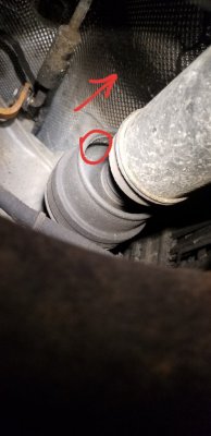

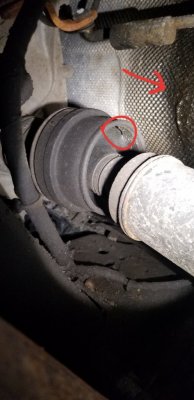

Gents,
Crawled under the PW today as I was going to change the oil, when I started to survey the underside. Really the first time getting under it since buying it.
Noticed the front axle seal / boot is torn and has flung grease to the underside as a result. Pics below:
You can see the tear where I've circled, and the grease where I have an arrow. Let me know if I need to take more pics.
Bought the truck with 17K miles on it and have no idea who the prior owner was and what they did with it. I did not notice any signs of hard offroading or anything (aka knicks and scratches on the frame / differentials, etc.) and have since put about 6K miles on it.
Y'all think this would be covered under warranty? Am yet to take it off road and only turned on 4x4 once to test it out and make sure there were no noticeable issues. Did not have it in 4x4 for more than 30 seconds, but I did notice quite a bit of shudder when turning on gravel. Not sure if this is normal or not but it was definitely more pronounced than in my 2016 1500.
Let me know your thoughts y'all. Hoping this is warranty and not "wear and tear".
Thanks!

Bumper to bumper for 36k. I think it is covered. Need to get that cleaned out greased and sealed up before the snow starts to fall.

Yup, already have my appointment set up with the nearest Ram dealer (20 miles away lol).
Speaking with the service tech, sounds like this is covered under the bumper to bumper and drivetrain.

Quick update...
Dealer ended up ordering me a new driveshaft boot and a new driveshaft.
Was not expecting the driveshaft needing to be replaced, but they're doing it just in case. I am okay with this.
They ended up loaning me a brand new 2020 Warlock 4x4. Not hating, but man it feels like I'm driving a Tacoma compared to my PW.
They're gonna have it for at least a week.

Update:
Heard back from Service Department... Said the driveshaft isn't due to arrive until 10/12. WTF.
He said I could take the truck until it arrives, but that he'd have to notify Ram that I elected to take the truck with a known issue. If the truck were to come back with more issues (other than the driveshaft / boot), that Ram could elect NOT to cover the warranty work.
What would Ram Forum do? I don't plan on turning on 4WD at all. Just want my cot damn truck back.

drive shaft doesnt turn in 2wd. i would drive the truck if it were mine

while back i put a gopro under the truck to see how the suspension works. i noticed the driveshaft didnt turn

Update -
Service advisor called and said the ship date turned to "TBD" and he could not guarantee a date of when the driveshaft would arrive.
Needless to say, I ended up picking up my truck. SO glad to have it back.
Again, nothing wrong with the Warlock, but sure as hell ain't no PW!
Advisor said it should be a 3 hour install once received so I will plan to drop it off that morning and get it back that later that day.
