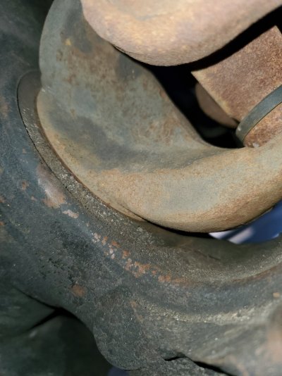

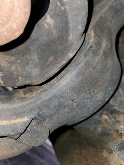

So I've got a 2010 Power Wagon, stock ride height. I've just finished installing a moog non adjustable track bar because I thought there was an issue with the adjustable Carli track bar I previously had on(which was adjusted as short as it could go). My axle is still sticking out on the passenger side, around an inch. I recently had a shop install the synergy HD steering upgrade, Carli ball joints and dynatrac freespin hubs. I figured there must be an issue with the hubs as the driver side doesn't stay locked anymore when I try to lock it. So I went under the truck to look and my passenger side axle shaft doesn't look all the way seated to me. I took a picture of the passenger side and driver's side. Before I go back to the shop that did the install, is this normal or is this what's making my tire stick out on the passenger side? My steering is also kind of sticky when the wheels are pointed straight, and loosens up when the wheels are pointed one direction or the other...

Something looks off in the Left Side Picture. Like its missing a bushing or not seated all the way. Does the spindle have play in it? (The part that goes into your axle that hold the U-Joint)

I took it back to the shop that did the work and they told me the axles are designed to float in and out... They also said they've seen new trucks with their axles up to 5/8" off center... Can anyone confirm this?
Before i noticed what you can see in the pics I had taken it to a different shop to look at the wandering issue it has. They checked the ball joints(Carli) for tightness by disconnecting the tie rods and moving each tire from lock to lock. They also checked for binding in the gearbox(Redhead) by turning the steering wheel from lock to lock with the pitman arm disconnected from the drag link. They ended up having to loosen the box up a bit cause the steering was tight around when the wheel was centered, and he said the ball joints were right between being too tight and just fine, but should break in and loosen up over time. They didn't mention any play of any kind. The wandering had improved a little, but I still feel like an 8700lb ping pong ball bouncing from one side of the lane to the other going around long corners.
