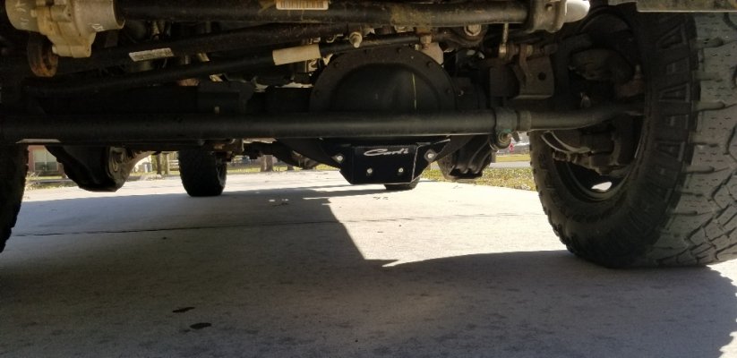

Looks like it will collect mud, how open is it?
Would you rather it collect mud? Or lose all your diff fluid?
But to answer your question.. not really. I just took mine in the mud this weekend.
If you take your truck in mud. You should immediately wash it when you get home anyway.
There’s plenty of nooks and crannies under our truck that collect mud. If you wheel in muddy conditions you should be rinsing the truck off when done so just hit the Carli guard with your hose to rinse it out.

4,581
Kewadin MI
this^^^^
of course its gonna collect mud...just like every other nook and crannie under the truck. A simple spray with a hose or power washer will fix that issue.
Halligan
Jun 15, 2015
230
234
Massachusetts
After rereading my post to DodgeDude I think my response reads a rather douche bag like and I didn't actually answer your question. So let me answer by saying it's open enough to rinse out any mud if you spray it directly with a hose. I've had mine on for several years and it's all good under there.
