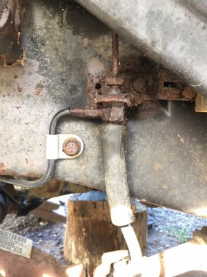

I am not finding info on removing/replacing the ...heavy duty lookin', rubber sleeved, brake line on the front Driver's side of my 97 1500. Can someone help me with DIY instructions to take off that line? It's the one coming out the bottom of the T in the picture below.

Dang. Now that I see the picture up close, I should probably just replace ALL brake lines ...up front. Maybe rears too. Dang, this project just keeps getting deeper and deeper.
I've seen pre-bent kits ...seesm like that would be the way to go? Any recommendations?

I'd probably just replace all of them if that's what I had to deal with. I doubt either of those lines would come out in one piece. The large hose has a junction box on top, the line to the left and the line above both thread into the junction on the end of the hose.
I replace all lines on my 96 last year (front & rear) with a kit from these guys - https://www.sstubes.com/ Pretty simple job and plenty of room to work under there, I would highly recommend doing all of them along with new hoses if you plan on keeping the truck. Nice to have peace of mind in an old truck when slamming on the brakes.
What size are the brake lines in our trucks - I'm not finding it?
