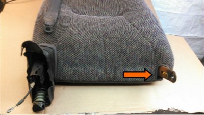

Please forgive me if I'm posting in the wrong place. I'm new to Dodge Forum. Had trouble finding where to start a thread. As my name implies, I'm "too old school". Don't like all the plastic and computerized systems on post 70s vehicles. In addition the last Dodge product I owned was a Bright Orange 1970 Roadrunner with 440 6 Pack, 4 sp. when I was 18. One fast bird!!!
My issue: Just purchased a nice 98 1500, 4x4 quad cab... Don't mean to call people names, but some moron cut the shoulder/ seat belts and stuffed the belts back in to the seat backs. Fortunately I have located good condition seat backs for pass and driver side that match my Agate interior. Can someone advise me? The outer side of seat backs look simple enough to remove from the seat bottom, but the inner side where the seat pivots (see photo) looks a little more complicated because of how the seat frame is made. The pivot area of the seat back appears to rest in between 2 pieces of frame on the seat bottom.I removed a nut from the bolt but there is no play in the bolt and I cant find a head on the bolt. Do I have to disassemble the seat frame to change out the seat backs?
Again, I apologize and thank you for your help
