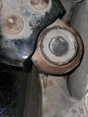

This is the cap I am talking about. Image attached. Have a ball joint press but that to part I think will have to be chiseled off

What's the new part look like? That setup looks to me like you remove the 4 rivets and the whole thing slides out of the arm.
Otherwise, you grind off that lip that is staked and press it out like normal. Replacement would most likely have a snap ring.
EDIT - Confirmed it's the second option.
