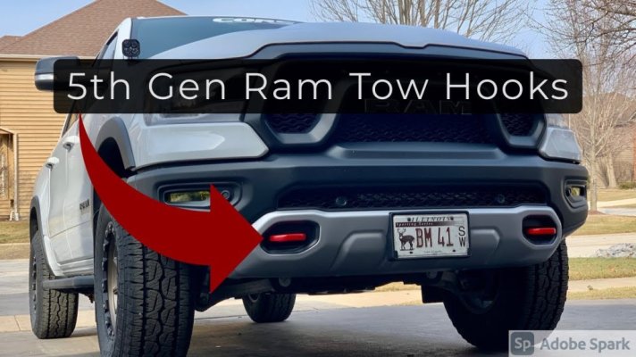

It would be very easy to replace your right side tow hook with a trailer ball mounting platform welded to the tow hook. The offset makes it easier to maneuver anyhow.

I don't think that I have tow hooks. At least the hooks themselves are not there. Should I assume that the mechanism for mounting the tow hooks is actually behind the grill? If so, can you explain a bit further about what a "trailer ball mounting platform" is???? Thanks for the response....
Dean2
Jun 17, 2021
4,492
9,042
Near Edmonton
2021 2500
Click on picture to see the whole thing. You basically weld a piece of flat steel on the tow hook and then drill a hole in the steel extension to attach the ball. If there ias no hooks you can still use the mounting holes and factory bolts and the holes are already there. maxresdefault-269254005.jpg

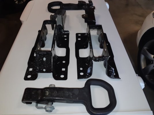

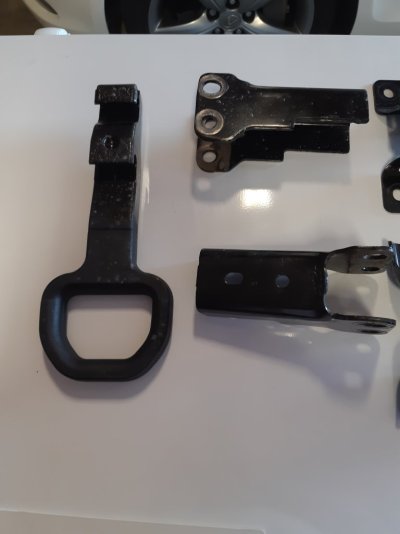

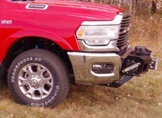

When they put the Warn transformer winch mount on my 2500 they used the original tow hook mounting holes to do it. They removed the tow hooks, mounted the winch carrier and it had tow hooks already on it. I sold the removed hooks and brackets. So you could probably do the same if you want a reciever in the front.
Warn does make a front receiver hitch assembly.

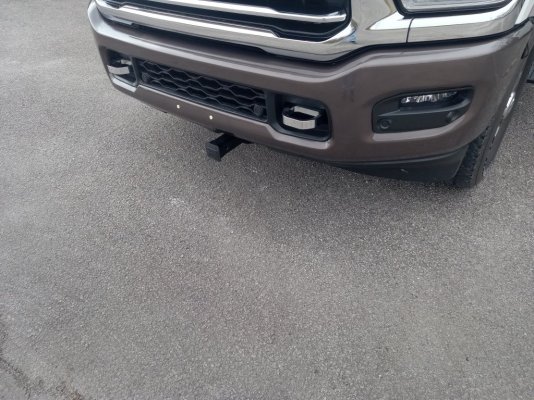

I have a 2500, and my front receiver is a curt. I will mention this, that even though it says it fits and it does bolt up. It doesnt stick out forwards enough for me to actually use it as it comes out the box. Had to take it to a welding shop and have the receiver modified (add length) to get out far enough to clear the front bumper.
