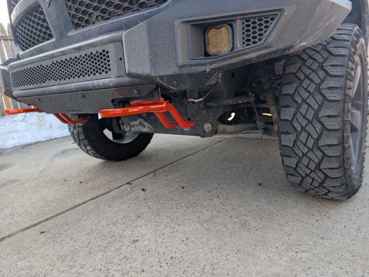

Those cheap Chinese ones will rust and the finish flake off pretty quickly.
So, if you get them, I'd suggest taking them right to a powdercoater and getting them done. Was only about $75 to have mine blasted and coated. Don't need to go with orange like me, but I like the way it looks. And they're coated with a base and a clear, so should be pretty durable.
