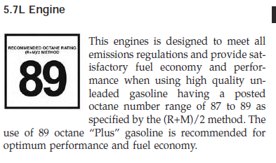

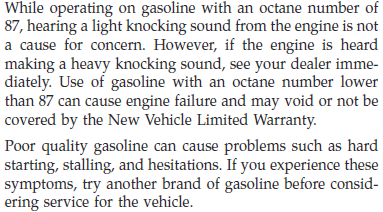

Don't need premium, that is a waste of money. Truck is designed to work at maximum efficiency at a lower octane level, follow instructions in manual. All your truck is doing is adjusting things to get it back to where it wants to be with lower octane.

So are suggesting a mid grade fuel? Or regular? I thought the hemi’s were supposed to run on mid grade fuel at a minimum
