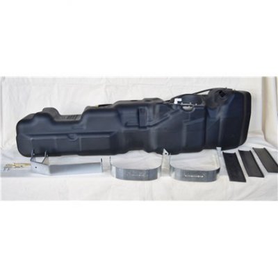

Went to the dealer last week with some issues, Fuel Gage among them... purposely left the tank below one quarter when I took it in, figuring they may want to drain it to check something. When I picked up the truck, the service writer told me the tech scanned the code on the tank and it's definitely a 31 gallon thank. The computer showed 17 percent fuel in the tank and the Gage read the same. They found nothing wrong. I used TORQUE to check the fuel level yesterday, and it read 6 percent. Did some driving down to 4.5 percent. That should have been a little over a gallon left in the tank. Went to my usual Top Tier gas station to fill up.... the most I could squeeze into the tank was 26.4 gallons. Maybe it's designed with a bubble in it that never fills, or the intake port for pump is too high, or only some engineer in an office is having some sport with us... but these tanks won't hold 31 gallons of fuel.

The fuel gauge is in the lower part of the fuel tank
The fuel filler tube is in the tallest part of the tank
There may be something built into the inside of the tank that keeps the upper part empty most of time, leaving room for expansion.
They may measure the square inches of the Whole tank to get the gallons that are stated in the owners manuals.
When actually the upper part of the tank never hold fuel.
You can see the hole in the center of this Ram fuel tank, that is where the Fuel gauge & pump fits in
https://www.ebay.com/itm/153814628717
Just a thought .....
Yeah, hears a thought.... It just SUCKS to be me.
