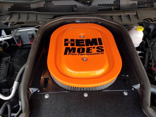

The stock air box does not restrict enough to lower mpg at highway rpms. That being said, thats a pretty intake!
