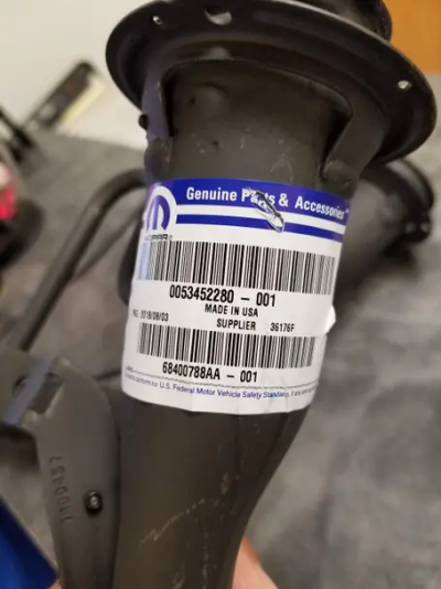

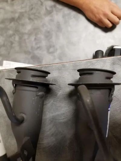

Problem solved. I bought a used replacement off of eBay, after viewing a part number on the hose.
2013-2024 RAM 1500 CLASSIC OEM FUEL FILLER TUBE ASSY GAS TANK NECK HOSE VAPOR
I had to remove the tire and fender well. I attempted to replace the hose all the way to the tank, but had difficulty removing at the tank. Instead, I left the hoses and replaced the cannister and plastic line. I would have save an hour and massive bruise if I had made the decision earlier. All good now. Parts were about $160 which included shipping and warranty.

A Ram owner proved to Mopar that their Fill Tube was in a Bad place, for the latest Gas Station pump Nozzles
The old Nozzles had the top of the air vent too LOW on the Fill Tube.
So Mopar moved the Air Vent up as far as possible on the Fill Nozzle as possible
There may be a newer Modification since this one ??
