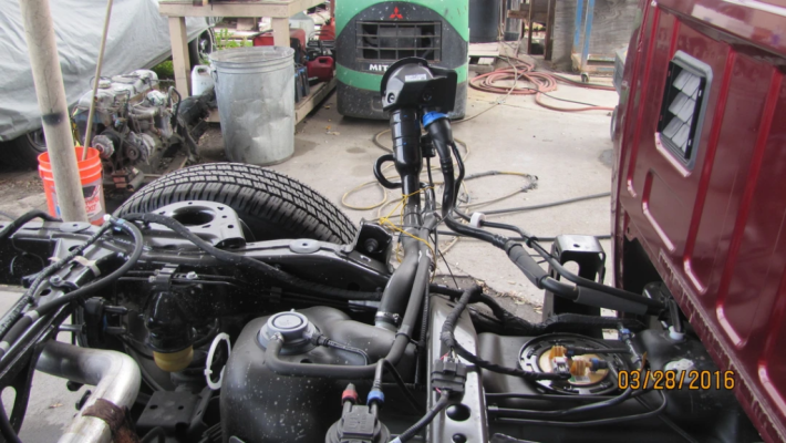

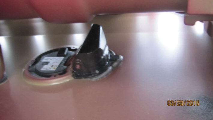

The diagrams above are from a Diesel Ram truck
My Ram is also a Diesel 1500 Ram
Pull your Left rear Tire, then you will be able to see almost everything about the Fill Tube
3 screws hold the Fill Tube up to the Fuel Door
