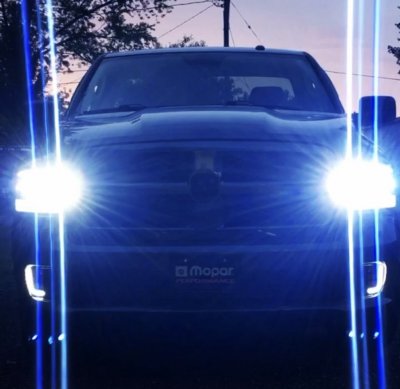

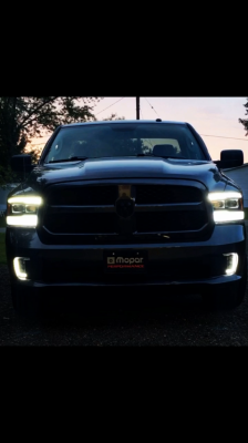

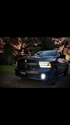

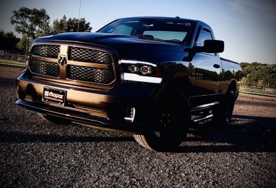

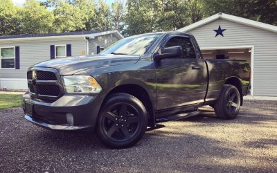

Got in my new alpharex pro g2 headlights and my amazon led fogs. Really dressed the front end up! The sequential turns and the switch backs and the start up/shut down knight rider style sequence is cool too.
here’s a couple before and after.

Seriously, buy these. They are great quality and I believe someone told me that the projectors used are either the same or very similar to the ones used by morimoto. The projectors have good cutoff, light output is excellent also. Quality leds and the diffusers for the leds look good... not like
on the cheap headlights where you see the individual leds easily through the diffuser. I did upgrade my bulbs to h7 leds highs and lows and they go well with my led fogs and are the same
Temperature. Very bright. Easily 3 times the output over factory I would say. I’ve got videos of them but unfortunately it won’t let
Me share. But I’ll include a couple screen shots from the video.
