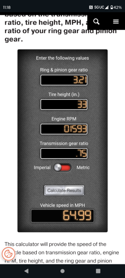

Using an online calculator and solving for engine RPM, using 3.21 rear end and .75 4th gear ratio, I get:
So, yea, somethings weird somewhere.

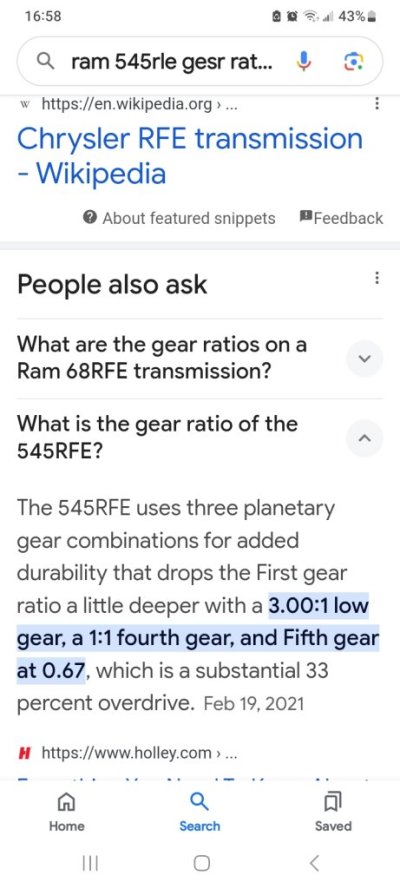

You're calculating things wrong,if i remember right i think 4th gear is 1:1,not 0.75.
Well that would definitely explain what he is seeing.
Just hit google. You win the cupie doll for today buddy.Screenshot_20240701_165813_Google.jpg

If you punch in 3.21 and 1.00,it comes out to what you're seeing

If i punch in 2175 rpm / 3.21 gear ratio / 1.00 transmission ratio and 33" tires i get just over 66 mph,not sure what numbers you're punching in but that's pretty well identical to your first posts numbers.If you factor in tire wear and say your tires are down to 32.6" it comes out at just over 65 mph for 2175 rpm.
You might want to revisit the numbers you're punching into the calculator,as you must be doing something wrong.
It's pretty obvious you have 3.21's,especially if you factor in your build sheet,which you have said your truck is equipped with.
