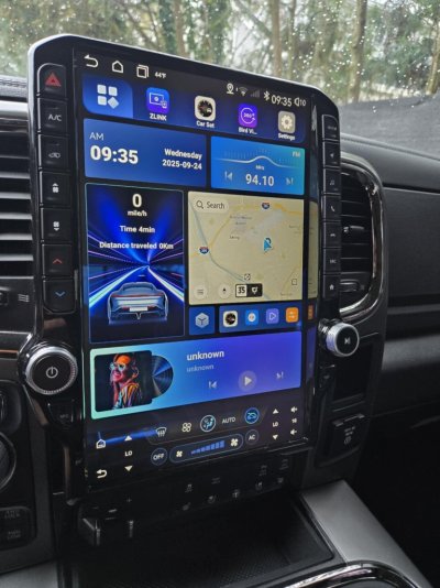

you could go all in and really change it up with a knockoff 5th gen 12" designed for the 4th gen. I tried it out, was cool, definitely different. Plug and play literally nothing needed to setup etc. Expensive but nothing else like it out there for this specific design:

Yes aftermarket plug and play wise. Factory wise you and I both have a uc4/5 12" solution but not exactly plug and play. Sticking with factory uconnect 5th gen swaps into 4th gen is the only way to go, just involved so not for everyone. I see your really dialing in the setup!

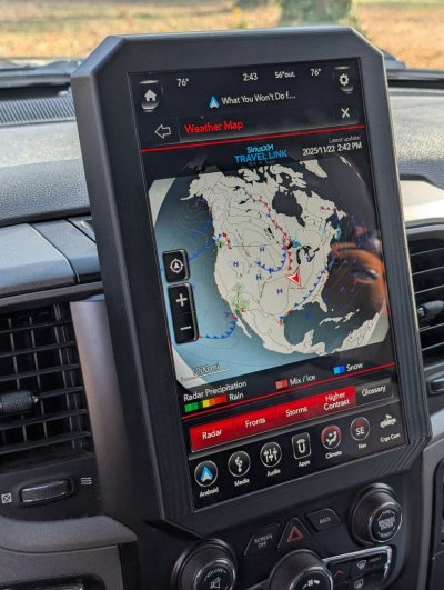

I get it...in my case a few more plugs and a lot of play but super solid! Never going back although someone might be talking me into modeling the 14.5" UC5 now that o hot my feet wet, got a second 3D printer too for some engineering filament.
