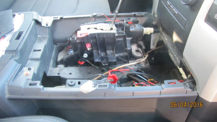

its a simple job
in the top image
look at the very top of image one, just above the shifter, you should see the mini light bulb
shifter handle
REMOVE the 2 screws, that are hidden under the rubber pad that is in the front tray that are at the base of the dash boards center stack.
In the bottom of the floor console tray, remove the large rubber pad.
GTyankee
Nov 2, 2020
12,391
17,459
El Cajon Calif. 92021
3.0 ecodiesel
Under the big rubber pad, if i recall correctly, there are 3 screws, ( 2 are silver, one is gold ), don't misplace them
There are 2 electrical connectors, cigarette lighter & a mini bulb that lights up the shifters positions, PRNDL
I believe that i am holding the connector that plugs into the cigarette lighter
ignore the new wiring, that is for the CB Radio
When you have removed all of the screws holding the tray down
If i remember right, lift the arm rest lid & the other cover too
Grab the back of the tray, close to the rear of the tray, jerk upwards.
I believe that is how i lifted the tray out, i may be confused with my 2016, i had to do that one also.
When you lift the tray, be careful of the small wire for the mini light, it is fragile.
Caution: IF your truck has the small access panel ..
If you decide to remove the little access panel, that is located in the side panel of the console, where the drivers knee may touch.
That panels clips break easily :(
