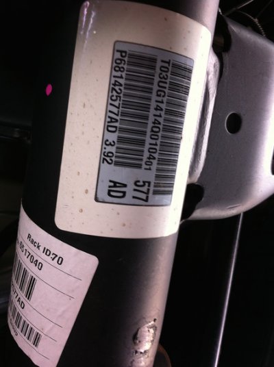

Look for a tag like this on the rear axle:
3.92s work a treat with the 8 speed, make the truck feel quick and don't hurt the mpg (much).:happy107:
