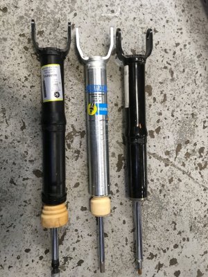

Pretty sure 4 gen 4wd struts will lower it about 2”. I’ve swapped 5th gen struts to a 4 gen and got about a 2” lift. The 5 gen is the one without the bump stop

I think I'm gonna try this. I have a bilstein 5100 laying around, so I just need to find a gen 4 spring seat. If the springs are the same diameter at the seat, I don't see why this wouldn't work. Gen 4 bilstein or stock strut, gen 5 spring and upper strut mount with some belltech rear springs...If it works, it'll make for a pretty cheap 2/4 drop! Should work for the summer while Inez finishes up the 3/5 for us 4x4 guys.
Bilstein has a billet spring seat but it comes with their 2" lift. Hopefully I can buy it separate.

I swapped just the strut used the 4th gen spring, top hat and seat
