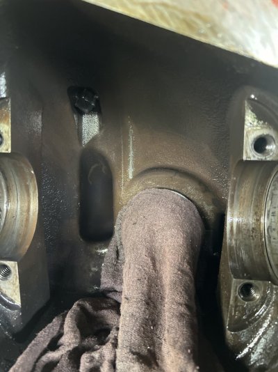

well sh$t I had some clearance issues with the carrier hitting the pinion at the two larger knuckle areas of the spicer 80754. lsd
what brand gears did you install? I just tried Richmond excels with clearance issues.

It looks like I may have to grind some of the rear housing to accept the gear. That’s the only thing I can find pertaining to the 06-08 range having maybe a slightly beefier rear housing and I have two headsets here CR925456
Richmond
And zig C9.25-456 standard gear set thinking maybe there was a difference in gears
It seams with a .024 shim set instead of .031 it fits and clears the carrier but the ring gear grinds into the housing in the rear most point

Here is a better view I’m fixing to grind it out so I can get the backlash within .06-.010 thousand
