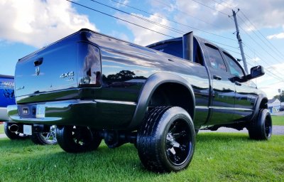

I have had My truck coated with Optimum Pro Ceramic coating and like the Adams Detailing products to maintain it.The Adams Graphene here in My area,Central PA,works well to be done in the shade or covered shop and at temps above 50 degrees.Below 50 it is very tough to remove and leaves streaks that keep you going over the vehicle driving you nuts.Remember,any more than 2 coatings of graphene and the use just gets redundant and wastes your product.
Maintence of the graphene is easy,I use Adams CS3 to clean and top coat it with Adams Slick n Slide.The depth you get is incredible.
Here is a shot of My Ram 2500,all factory paint except the hood still from 2005....3a.jpg
