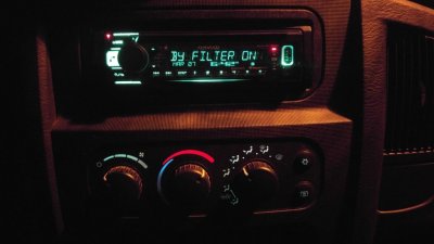

Hey guys, lately I've been noticing the green lights and the climate control illumination lights fade out, like overtime...
I'm wondering if there is anyplace to get OEM lights? i don't want LED or anything else cause its too bright for my liking.. Any advice is greatly appreciated, thanks!

Any mopar online or dealership has them, there’s three different ones, one type for climate, 3 bulbs, one type for dash, 11 bulbs, and one for light switch, 1 bulb.
