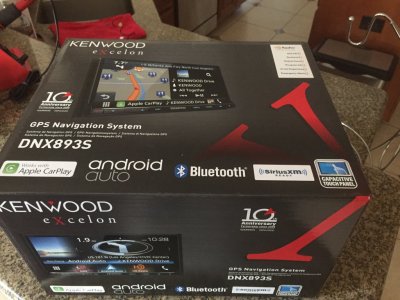

I redid my entire audio system and it was working stellar until my 2 year old Kenwood head unit crapped out last week and I replaced it with this new Kenwood. Now that I swapped my HU out, I have a nasty ground loop. This was surprising, as I reconnected (re-soldered) the harness, and other than the length of some of the extensions (USB, rear/front camera video-in pigtails), all the connections are the same.
I started chasing the buzz. I did notice I initially ran the remote power connection wire in parallel with my RCAs along the passenger side, back to my amp (dummy move). I re-ran it, and the buzz did lessen, but it is still there. I also noticed the aftermarket rear camera video RCA dropped much of the loop when disconnected (this little guy was flaking out on me anyway, so I plan to replace). I have since left it disconnected, and removed it from the switched power, too.
Even with the amp/sub not powered on (disconnected remote power wire), and running only speaker line-in to the dashspeakers, there is some buzz, albeit faint.
Having said all this, is it possible that the new HU has greater resistance than its predecessor? Do I need to ground it to the chassis and not rely on the ground wire currently in play between the harnesses?
I am pulling my beard hair out here chasing this down.
